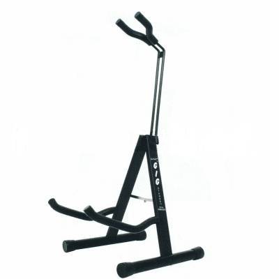

I not really a believer in putting guitars in stands, in my opinion the only two places for a guitar are in my hands being played in safely in its case. That said, however, I have started to play a number of recitals where I need both guitar and lute on stage, so I need a stand for the guitar (I'll have to make one for the lute). The guitar in question is an $8k Aram so I don't want to just prop it in the corner!
So, the question is this, what type do you prefer, the A-frame or the giraffe neck? Is the advantage of the lower centre of gravity of the A-frame outwieghed by the neck support of the giraffe neck design?

I don't own a $8K Aram, but I have put my strats and teles and an occational acoustic in both types of stands that you mention, and I much prefer the A-fame. I have used them on crowded, dimly lit stages for years, and my guitars seldom get knocked off the A-frame stands. On the plus side are the low center of gravity that you mention, but also a larger footprint (my "giraffe" stands had 3 contact points on the floor, my A-frames have four), and they are smaller when folded up. On the negative side... can't think of any! Make sure your fisih doesn't disagree with the padding material on the stand.

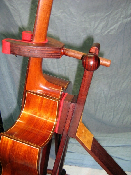

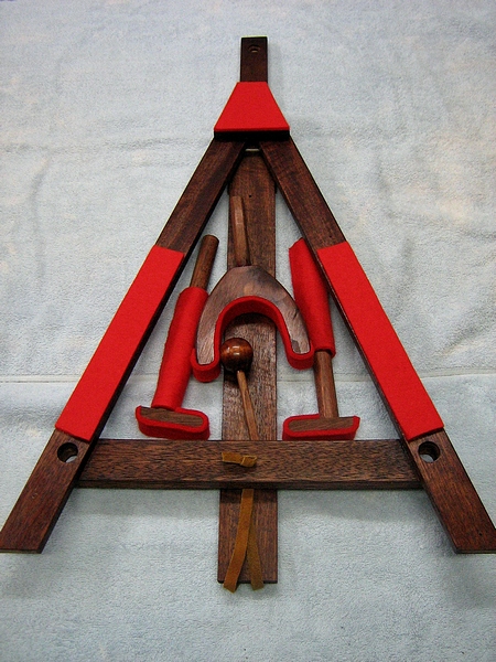

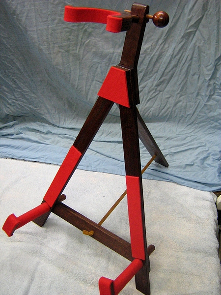

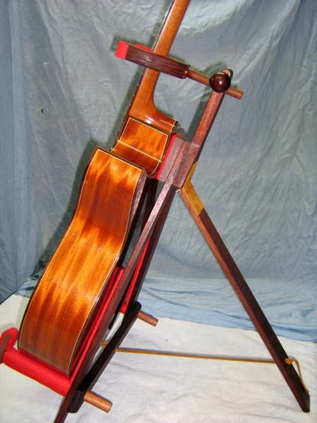

I,ve not been happy with the store bought stands , so knocked this together .It snugs the guitar very well . The neck support is easily adjustable for different width guitars via a simple wedge ( with the round handle ). The angle set can be adjusted by lengthening the buckskin strip . I used no metal ( leather hinge) and cushion felt from my piano supplies .

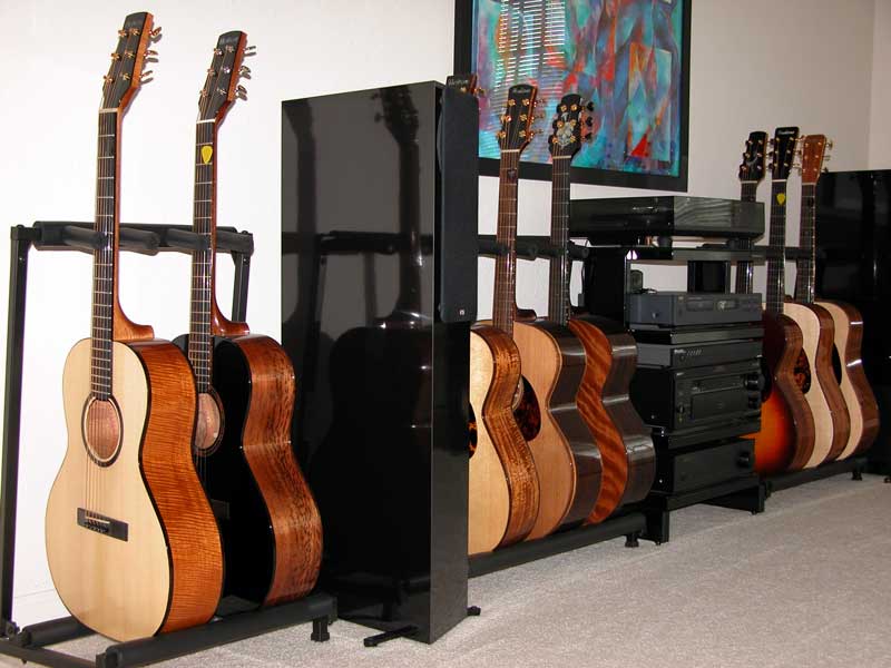

Hesh! This is and old picture. Shurly this rack and 4 more like it are full by now

Thanks Arnt and Mike, I was leaning towards the A-frame type so I might go ahead and get one of those. But I do have some bits of rosewood and Yew in the pile so one like Craig's is a definite project.
Nice though those are Hesh, not very practical for what I was after. I don't like keeping guitars in stands at home, I like to keep them in their cases when not being used. I just need something to go next to my chair on stage to take one guitar.

Thanks Colin and John. I've noticed the store bought ones are made to suit electrics as well , and as such have a narrow width between the bottom lower bout rests. Mine is for acoustic guitars , and has this width wider . As you can see , it supports the guitar at the lower bouts , back of the upper bout and adjusts to support the neck as well.
I came up with this design on the fly , and was so impressed with it's performance , considered making some as it flat packs.
You're welcome to use the design , but would like it referred to as the Lawrence of Australia Stand
List of materials include wood, leather, felt , hotglue and a bit of shellac . Sort of Old World ingredients .
As I said above ,it is very stable and supports the guitar better than any others I have seen

I hate it when you don't hear the end of a story, so I thought you might like to know that I bought one of these. It is really a hybrid between the two types, having the low centre of gravity and four point footprint of the A-frame plus the neck support of the giraffe type.

Jesus Hesh I want to live in your house

[QUOTE=Hesh1956] I like these stands.
Jese Hesh I wanna live in your house
Barry
PostPosted: Thu May 24, 2007 4:36 am
Geez Hesh,
Don't you get a lot of "unrelated" sound when listening to the stereo? Or is that how you break 'em in?
